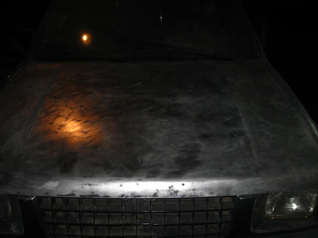

I started taking off the many layers of paint on there...
The hood after a lot of sanding and scraping...
And after a coat of etch primer

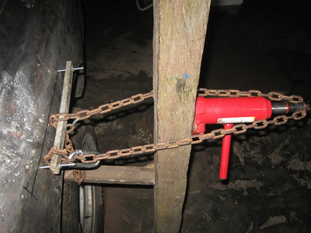

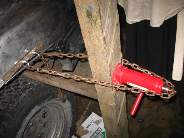

I don't have auto body repair experience, or equipment so I rigged this up to pull it back out.
Further up, pulling again.
Kinda weird, but it worked pretty well.

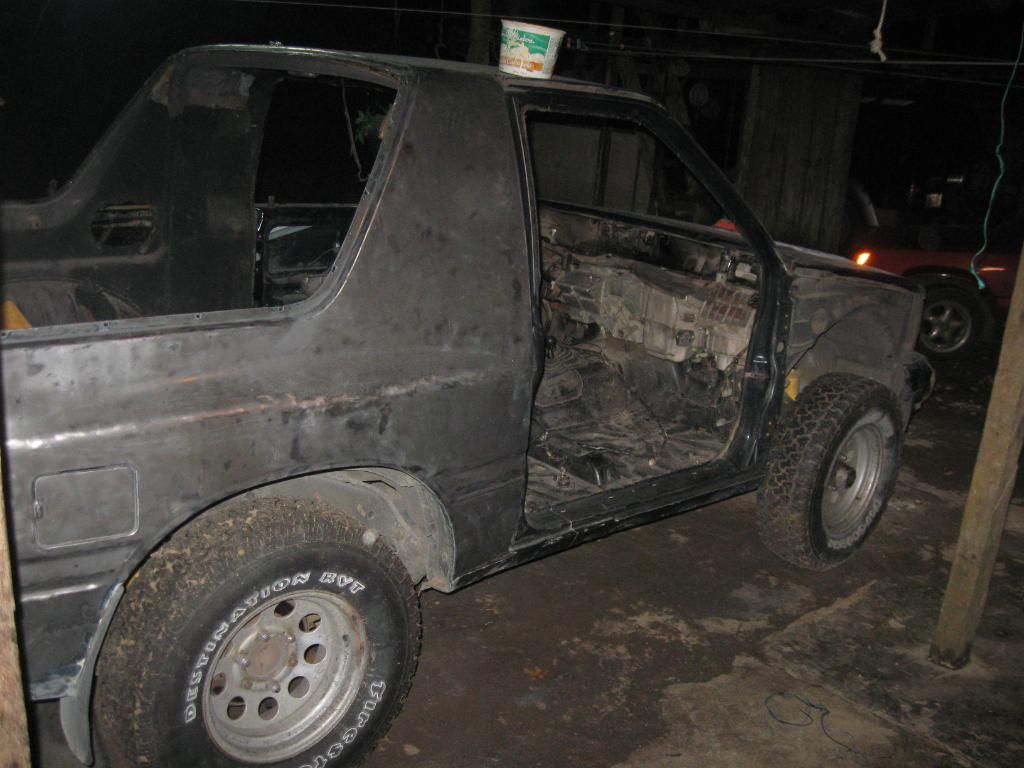

Current status went from this
to this yesterday

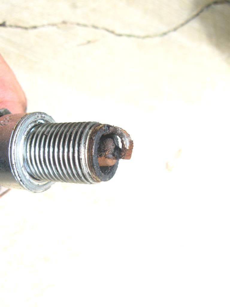

I changed the valve stem seals and the timing belt too. The seals were past bad and the valve cover was leaking. I passed the emissions test even with the bad seals though. Take a look at the plugs.
I installed some NGK V-Power plugs now.

I think it's safe to say this thermostat is toast...
