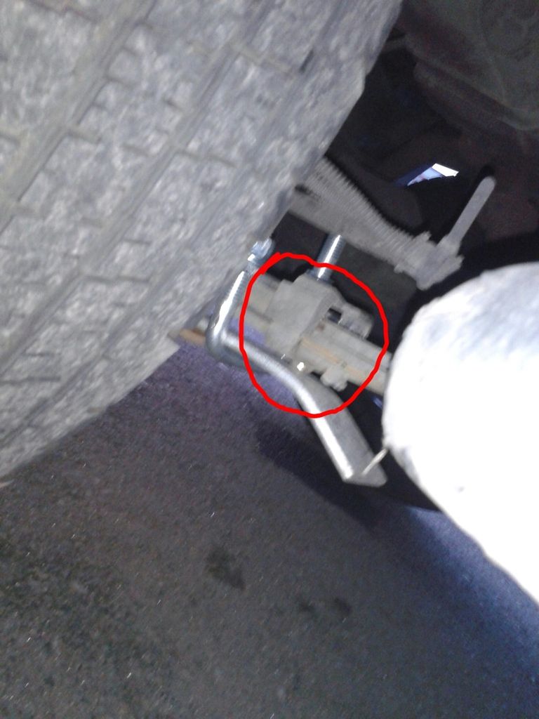

Which brings me to a question, what did you do about this: (this is the front end of spring, back doesn't have this problem)
Did you have it this way, or did you figure out how to get that clamp thingy off a there? I don't like it sitting on that rivet knob whatever you call it, but looks like you need heavy machinery to get it off.

Yes mine sits just like that. I said screw it and left it like that lol! It wont hurt anything and it wont be noisy as long as you used the added u bolt things to tie it down tight
