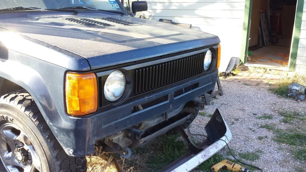

I started my round headlight conversion.
Instead of the regular ol conversion I opted to install a headlight wiring relay harness. With this harness I wired one of the headlight plugs into the harness itself and that connection activates the relay harness when the lights are turned on. The harness is wired to the battery and independently grounded. The power to the headlights no longer has to travel the Troopers wiring harness to the switch then to the headlights. Hopefully it will produce a nice current flow and brighter headlight.
The grill is pretty hammered. A former owner painted the thing a school bus yellow color and what I can only guess it spray can bed liner.
It's gonna take much more work to get it ready to install. The install is complete except for the refinishing of the grille.

Ok I finally got around to finish the install of the round headlight grille. I cheated though, last weekend I bought a 86 diesel Trooper that is in pretty rough shape. However it looks as if the engine is good and alot of great parts. So instead of sanding on the grille, I took the one from the diesel. With a bit of cleaning up and a couple coats of Fusion satin black here is the completed round headlight grille. Personally I dig it.......

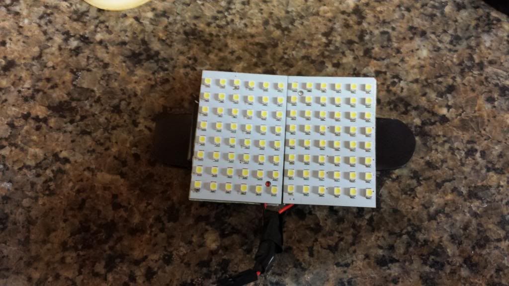

So then I decided it was time to upgrade the interior lights. I had ordered some LED panels for a engine bay light project and since I was going to use 2 for it and I had 3 from the 5 I ordered, I went to work.

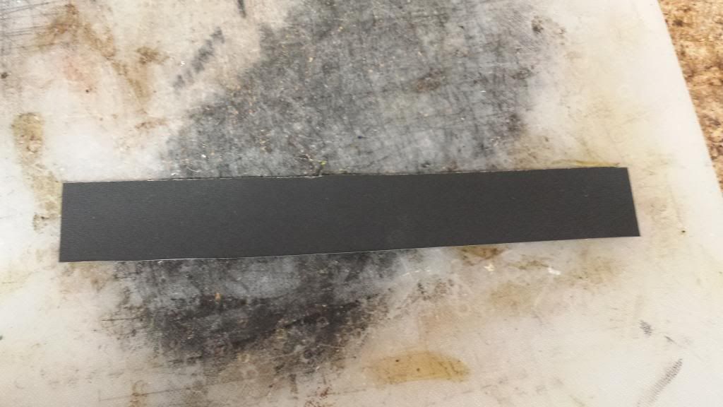

First I needed a way to mount the LED panel, so I took some kydex plastic. Kydex is frequently used by knife makers to make knife sheaths and gun holsters. You apply heat, the plastic becomes pliable and mold-able. I cut the sheet into 1" strips.

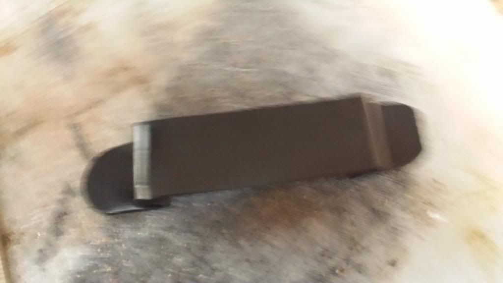

Then I applied heat and bent the kydex to shape to make a bridge over the light contacts inside the housing.
Image Sorry for the blurry photo.

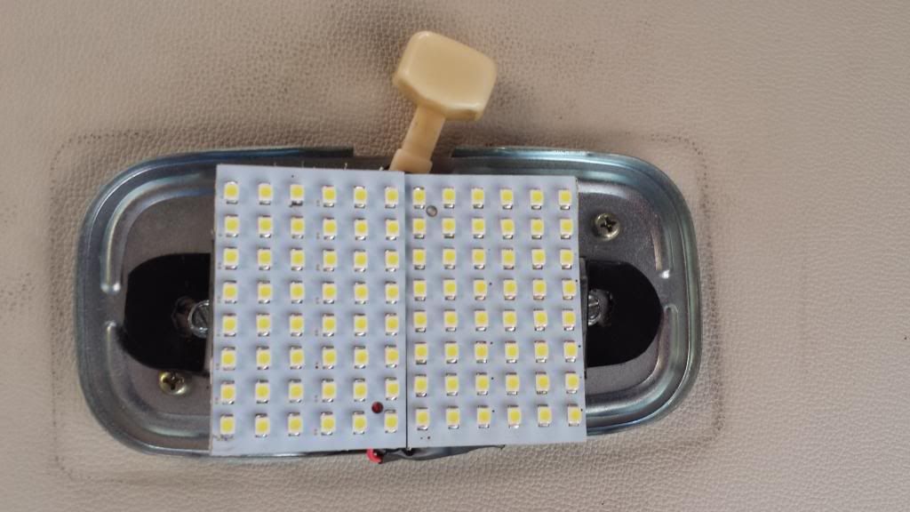

Next I decided I wanted to install two panels in the housing up front and one in the housing over the cargo area. So I soldered the two wires together and installed the adapter for the bulb that was included with the LED panels. The panels have 3m sticky tape and I mocked up the two panels side by side.
Next I went to the Trooper and plugged in the lights to verfiy they both worked and marked the locations for the screws. The housing have holes already there, so I used a couple self-tapping screws to install.
You can see in the photo my holes were not very accurate but one the cover is on it looks like I knew what I was doing! LOL

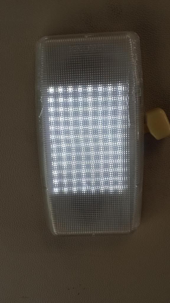

So now, I am waiting till dark to see the fruits of my labor.
