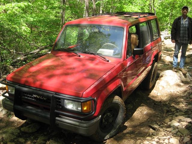

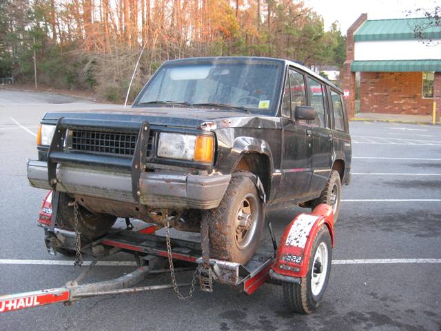

So this is a screen capture from a video lowzone took at URE this past spring, with the help of Joe D. littleredtrooper made it up Dutch John her first time out, which also happened to be her first time off pavement not including the 30 minutes we spent the day before in a dirt parking lot:

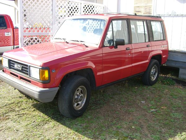

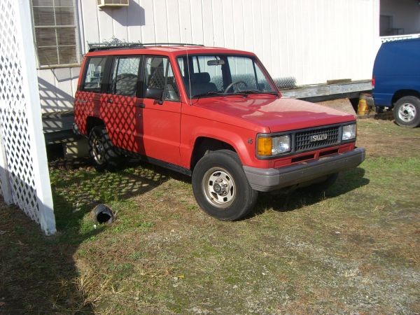

But the story starts about 10 months earlier when after searching for weeks for an older Jeep Cherokee, this guy popped onto Craigslist:
I knew very little about Isuzu Troopers then, but it was totally rad and within the budget so we popped on it immediately and brought it home:

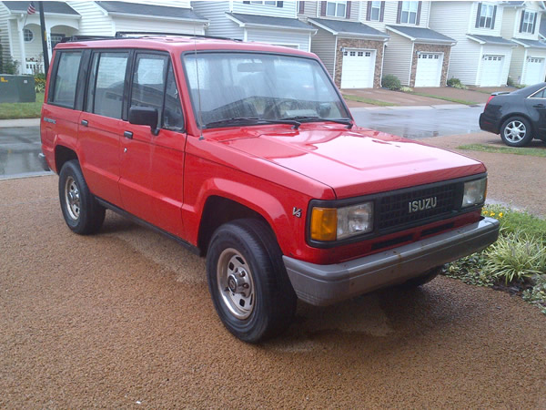

The Trooper was/is a 1991 V6 automatic, 264K miles when we bought it. The overall condition of the truck was good, the frame and body had very little rust and there were no major signs of abuse, it was mostly just in need of some maintenance and TLC. I hadn't worked on cars for years and wasn't even that good at it when I did, but that was part of the appeal and thankfully I came across a site called "Planetisuzoo" which I credit for a lot of what I've been able to accomplish to date.
The previous owner apparently bought the Trooper as a project but due to health issues never got into it so it had basically just been sitting outside his shop for a few months. The first repair for the rookie wrencher was the starter which went South basically the day we bought it. :roll: The repair was comical as I had no clue what I was doing, but I worked it out with lots of guidance and support! Old one out:

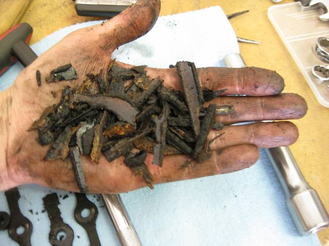

The maintenance continued, brake pads were next which led to one of my first "speciality tool" purchases - one of these gizmos which makes it *much* easier to get the piston back into the caliper than pliers by the way:
There was a torrential rain storm right around that time which helped explain why the Trooper didn't have a headliner... yep, most of the rubber gaskets on the roof rack rails were shot so it was leaking like a sieve. :roll:
I'm a total project nerd though, so had fun doing the overhaul which also allowed me to get the roof waxed:

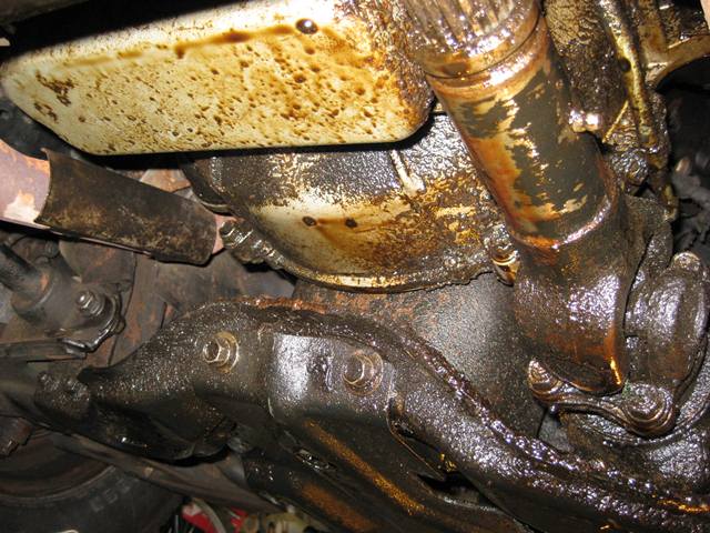

When I looked at the Trooper initially I didn't see a drop of oil after I took a test drive, although I'm assuming because it hadn't been driven in a while that the more I drove it, the more spots started to spring leaks to where it became more or less like the Exxon Valdez:
The top side of the engine didn't look too bad, so I got suggestions on what spots might be leaking which ultimately included several and made me realize that the Haynes repair guide just wasn't going to cut it, so ordered the Isuzu Workshop Manual which cracked me up when I got it... yeah, just a little more comprehensive:
The worst leak was probably the o-ring on the distributor which looked like this:
The rocker arm covers ended up being pretty bad too:
After poking around at a few other things I got things to the point where it still leaked a bit, but not gushing like it was before so decided to close out that project and move to some other odds and ends including an attempt to fix the wobbly speedometer (note the word "attempt"):

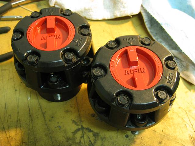

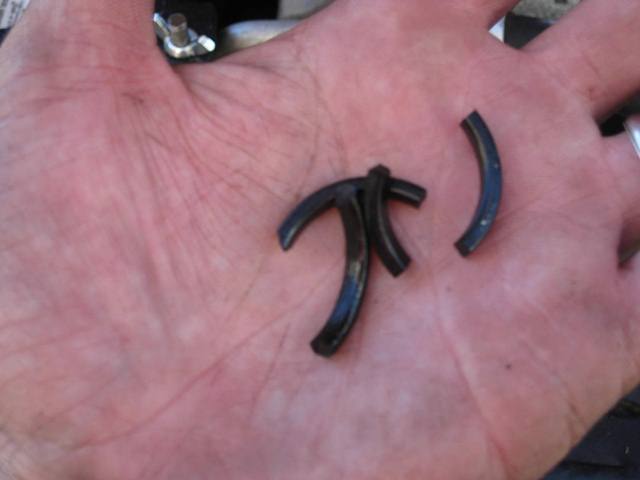

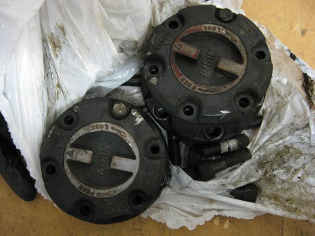

The last two projects I did for the year was refurbishing a set of Aisin manual hubs which I scored for free:

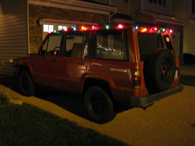

And getting it dressed up for Christmas! :)

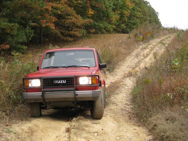

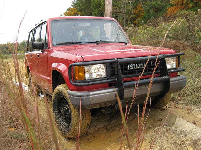

My daughter (aka "littleredtrooper") was driving basically full time by that point so what was briefly a Trooper we shared became her full time daily driver. As for me? Yeah, you might say I was hooked... it took me all of two months before I popped on a poor beat up 1990 Trooper for myself and dragged it home... literally! :roll:

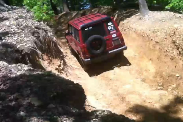

Which leads us back to this:
Still stock, but showing what it (and its driver!) was made of! That day was another turning point, my daughter was nearly as jacked up and goofy about the experience as I was, so before we even left URE for the day we had a list of the top upgrade priorities to get done! LOL!! Another big shout out to Joe D., I'm not sure the day would have ended up as good as it did without his generous help and care. :thumbup:

While the auto locking hubs did well the first time out, I found a set of Aisin manual hubs at a local yard for $20 so popped on them. Before:
And after refurbishing them:
And after swapping them out along side of my 1990:
They did well on a short trip back to URE with a few other locals, as did it's driver again! :thumbup:

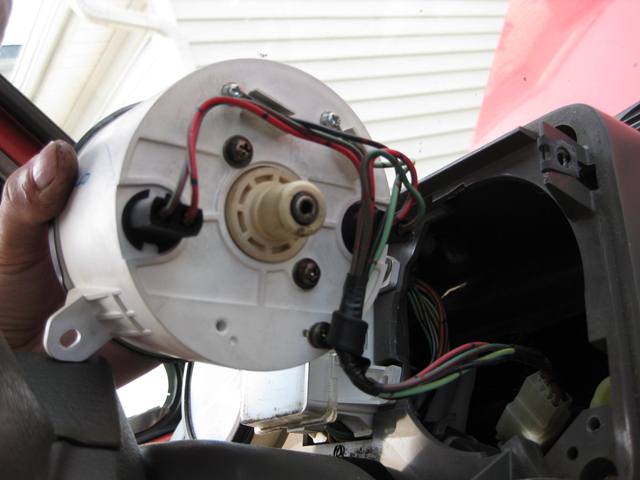

One of the things that was driving Zoe nuts was the radio... which was factory and worked for a short while, but slowly conked out and had a horrid squeaking sound that I was never able to get rid of. It got so bad she finally had me rip it out before we hit the trails on the last URE trip! :shock:
So while I was at the LKQ in Greensboro I snagged a replacement, I had the choice between some newer, aftermarket ones but decided to stay authentic:
I took the time to do some rewiring so it's grounded properly, works well and no squeaking!
I'm going to dismantle the previous one in order to determine if there's a way I can add an iPod input as opposed to having to use a cassette insert gizmo.
