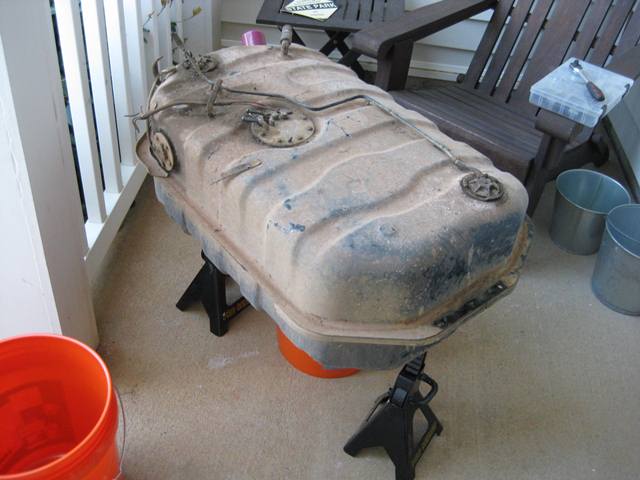

The seller's son had already dropped the tank and some of the hoses/wires had been damaged in the process, so I removed it and chucked it in the back of the pickup for the trip home - first order of business this morning was to get the skunked gas drained and the tank off the front porch before the HOA woke up.
