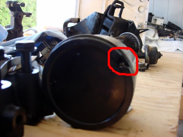

What are your guys thoughts? What could have went wrong?

did your timing belt brake? broken valve spring?

DAMUDKING wrote:did your timing belt brake? broken valve spring?
Timing belt fine, and spring looks ok, but i haven't taken it apart, but looks good.

emmagator wrote:What are your guys thoughts? What could have went wrong?

my guess on the problem from what i see in the photo. the valve stem where the keepers are broke off. or, a piece of spark plug fell into the chamber.

probably burnt in place or sometimes if you leave a truck parked not running for a long time the valves can stick open. especially exhaust valves from rust, humidity from outside and soot, carbon in the engine.

Sassee's latest 2.6 Trooper has a damaged crank pulley Woodruff key, which might have allowed the belt timing to change. He just started to pull his engine apart, but he also has a daughter getting married this weekend, which may have slowed the teardown somewhat. Appearantly these go suddenly with minimal warning. Worth a look.

Postby sassee » Fri Jul 16, 2010 10:07 pm
Yeah...........................
I just got back from a short vacation with the wife. I may be looking at the same thing when I pull the LS apart. It'll probably be a while on mine though, too darn hot down here!

Postby emmagator » Fri Jul 16, 2010 11:23 pm
Taking the block into machine shop on monday, if it checks out ok then ill purchase a new 2.6l head from Clearwater. :wink:
